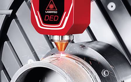

LASERTEC 65 DED Blade
High-performance Additive Manufacturing of metallic 3D-parts
  • Laser head integrated in the headstock for higher building volume and more additive performance
  • 5-axis material deposition by coaxial nozzle for homogeneous powder distribution, independent of direction of laser deposition welding
  • Dedicated additive solution for prototypes, small-series, repair and coating
  • Integrated thermal imaging camera for observation of the whole working area, adapive process control and constant monitoring of the working distance
  • Powder feed rate sensor as well as automatic powder calibration.
  • AM Evaluator for visualisation of the relevant process data (e. g. meltpool size, powder mass flow) as a digital 3D-model as well as in the chronological sequence
