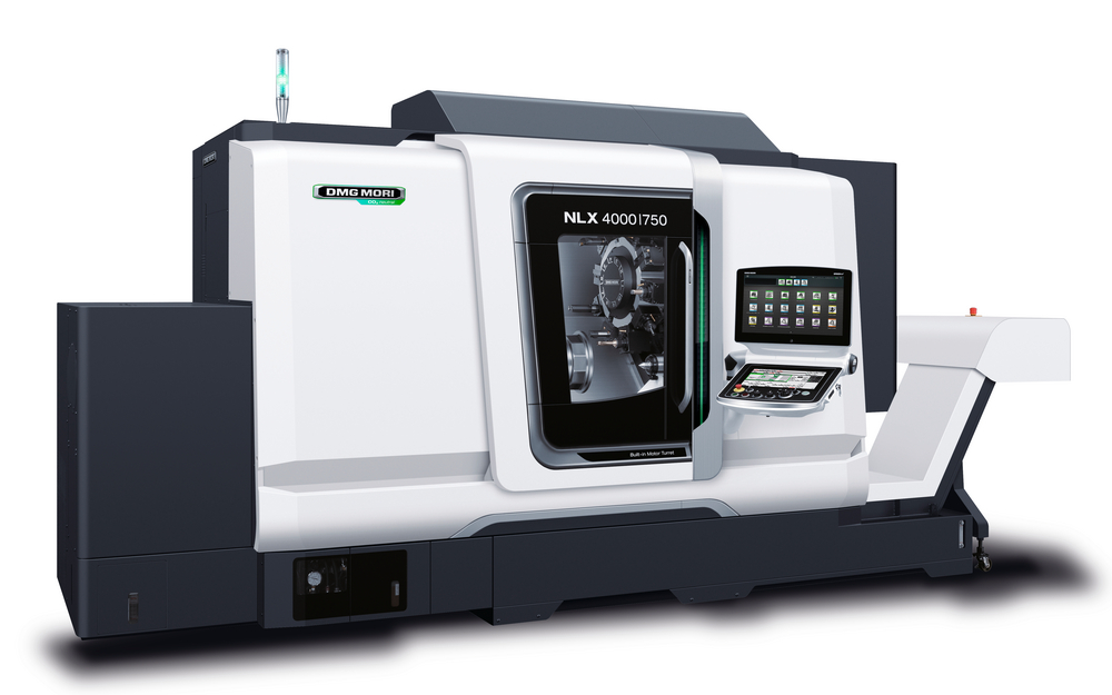

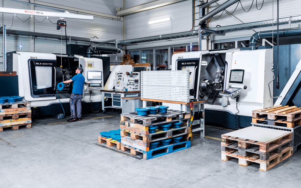

NLX 4000 – heavy-duty machining of workpieces up to ø 500 mm
The range of components at Karl Georg mainly centers on rotationally symmetrical steel components in a wide variety of diameters and mainly in small series down to a batch size of 1. “This means we have to be able to react very flexibly in production,” says Philipp Hüsch, who is responsible for tool management at Karl Georg. The long-term cooperation with DMG MORI has resulted in the installation of four NLX turning centers since 2017 – one NLX 3000 and three NLX 4000s. “We benefit from the stability of the NLX models for heavy-duty machining,” adds Andreas Löhmann. The compact design in relation to the 600 mm turning diameter in the larger model was also an argument in favor of using these machines.
