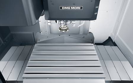

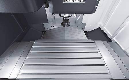

  • Super-wide slideways (X- / Y-axis) to minimize quadrant projection
  • High-rigidity roller guides (Z-axis)
  • Optimized column shape substantially reduces thermal displacement
  • Coolant tank for collecting casting sludge (option)
  • Through-spindle coolant system (unit on coolant tank) <option>
  • Chip conveyor (internal, spiral type) <option>
Pursuit of usability
  • Accessibility - excellent access to the table and a wide door opening
  • Loading and unloading with a crane - the ceiling part also opens
  • Replacement of spindle unit - the spindle unit contains a cartridge which even includes the rear bearings,
Outstanding machining capability, unmatched high-performance spindle
  • World’s Best Spindle Technology
  • No. 40 taper spindle achieves outstanding high-speed machining (speedMASTER)
  • Stable high-accuracy machining made possible by drastically improved spindle run-out accuracy (speedMASTER)
  • No. 50 taper spindle achieves outstanding heavy-duty cutting (powerMASTER)
  • Thermal expansion compensation by spindle growth sensor (powerMASTER)
