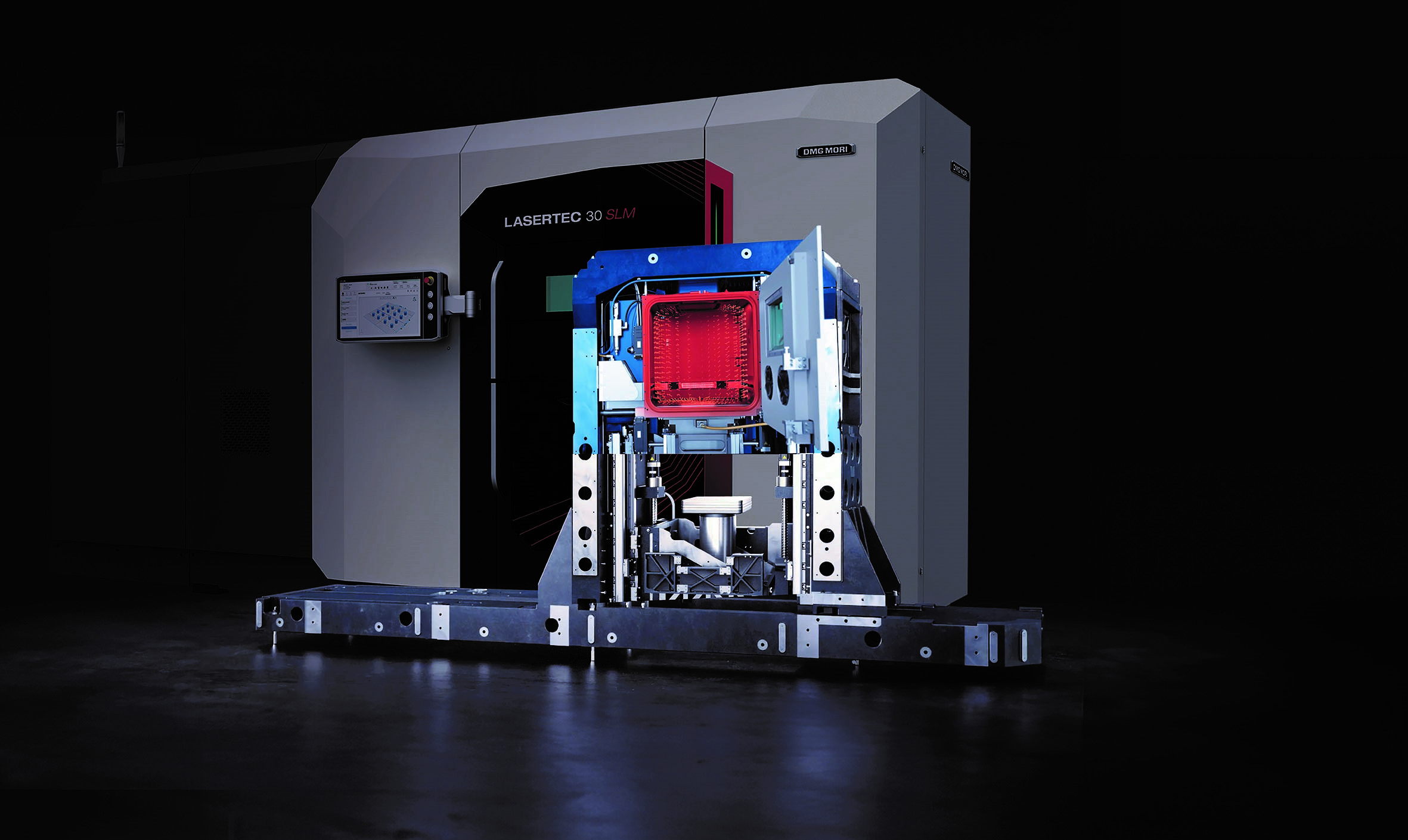

The most obvious feature when looking behind the sheet metal is that the primary structure of the LASERTEC 30 SLM Gen 3 utilizes castings, applying the same design principles used on the majority of DMG MORI milling and turning machines.
While using a casting is standard practice for DMG MORI it is new to additive manufacturing. A casting base guarantees the best rigidity and predictability for part manufacturing.
Unlike machine tools, there are no lateral forces from the movement of the axes on a LASERTEC 30 SLM Gen 3. However, temperature changes that cause thermal expansion within the machine are inevitable. DMG MORI has years of experience in minimizing the effect of and compensating for temperature changes within its products. Great care has been taken to ensure that the process chamber is an isolated unit within the machine. Therefore, the Floating Process Chamber is free to expand in all directions during temperature variations, thus decoupling it and any thermal affect from the build plane. Likewise, the  optics are mounted on the rigid casting Gantry Frame, isolated from thermal effect. To further ensure a build free from thermal expansion, the recoater is also mounted to the frame and decoupled from the Floating Process Chamber. In addition, the Z-axis on which the build is mounted, is actively compensates for displacement. Through this thoughtful design, problems related to the position and distance between the optics and the top surface of the powder bed can be eliminated.
