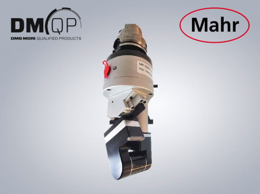

MarSurf MC 510 surface measuring system from Mahr: The MarSurf MC 510 system will be the latest addition to the global DMQP portfolio from September. Dr.-Ing. Masahiko Mori, President and CEO of DMG MORI Co. Ltd., and Manuel Hüsken, CEO-Chairman of the Board, Carl Mahr Group, formalized the cooperation between their companies for the DMQP distribution of the MarSurf MC 510 contact-free measurement system in mid-September.
The special feature: "With this system, users will be able to measure the surface roughness of workpieces, for the first time, according to the standards DIN ISO 4288/4287 and DIN ISO 21920-2: 2021 directly in the working area," explained Dr.-Ing. Masahiko Mori, President and CEO of DMG MORI Co. Ltd. "Furthermore, the measurement results of the MarSurf MC 510 are consistently reliable and, most importantly, can be documented in a legally compliant manner,” added Manuel Hüsken, Manuel Hüsken, CEO-Chairman of the Board, Carl Mahr Group.
In operation, the Mahr measurement system is programmatically selected from the tool magazine, positioned at the measurement location, and then precisely locked in place for the autonomous measurement process. The measurement process itself is controlled by a separate Edge PC, which communicates bidirectionally with the mechatronics of the measurement system via Bluetooth. The edge PC also interacts with the machine's CNC control via OPC UA. The MarSurf MC 510 is controlled from here via NC code, and the data obtained is also available for further analysis. By spring 2025, the system is expected to be fully integrated into the APP-based CELOS X control platform of DMG MORI.

Highlights: MarSurf MC 510
  • Automated surface measurement according to standards DIN ISO 4288/4287 and DIN ISO 21920-2: 2021
  • Automated in-process measurement of surface parameters in the working area
  • Reproducible results with maximum precision
  • Standards-compliant and legally secure documentation of surface parameters
MarSurf MC 510: The MarSurf MC 510 enables, for the first time, standard-compliant in-situ measurements with an accuracy of up to Rz 1 directly in the workspace.
