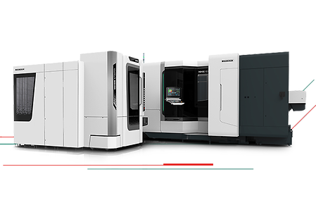

CPP (6 stations) with NHX6300
  • 1 layer pallet pool solution in multiple possible setups for automated, unmanned operation fit to customer facility:
    • straight line arrangement (S) or right-angle arrangement (R)
    • Up to 29 pallets and 2 work setup stations / up to 4 machining centers (on request)
  • Easy operation using machine controller of machine center with pallet manager
  • Optionally, DMG MORI´s own cell controller “MCC LPS III” is available
  • MCC LPS III is added from 2nd machine in one CPP by default
  • Space-saving automation at low cost
  • Combination with various kinds of options
