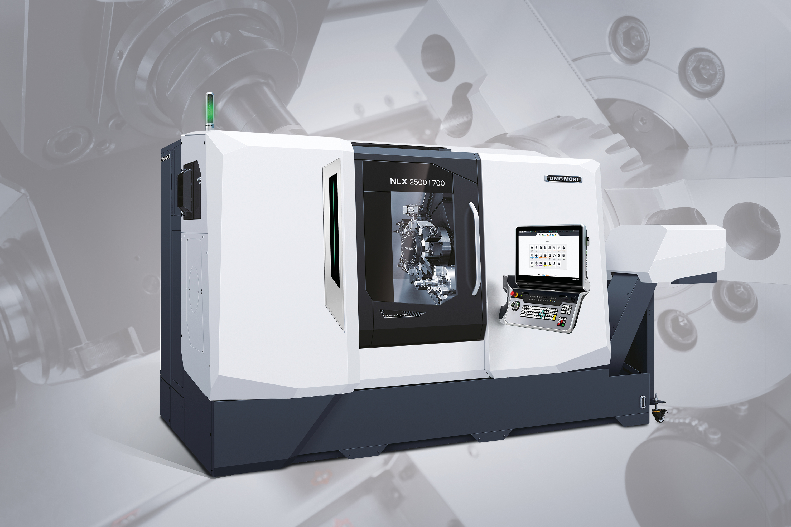

At the Chicago Technology Days DMG MORI is presenting the NLX 2500|700 2. Generation, a successor model of the best-selling turning center, implementing deep-reaching optimizations in machine structure, control and various functionalities.
The innovation leader has considered the requirements of today's markets and embedded the new model in the Machining Transformation (MX) concept. Process Integration, Automation, Digital Transformation (DX) and Green Transformation (GX) are the key pillars of this concept with which DMG MORI is shaping the future of manufacturing. The NLX 2500|700 2. Generation provides users with various needs with maximum flexibility and running autonomy in universal turning. The core characteristics of the powerful NLX series – its stability and the associated precision – have been enhanced even further. The aim is to reduce throughput times and increase machining quality. With these measures and the adaption of high torque turnMASTER spindles on the left and right, the NLX 2500|700 2. Generation will continue to set standards in the productive heavy-duty machining of demanding workpieces.
DMG MORI has embedded the NLX 2500|700 2. Generation into the Machining Transformation (MX) concept.
Precision machining for a wide range of workpieces
The NLX 2500 2. Generation offers users in key industries such as automotive and medical maximum flexibility in universal turning and heavy-duty machining.

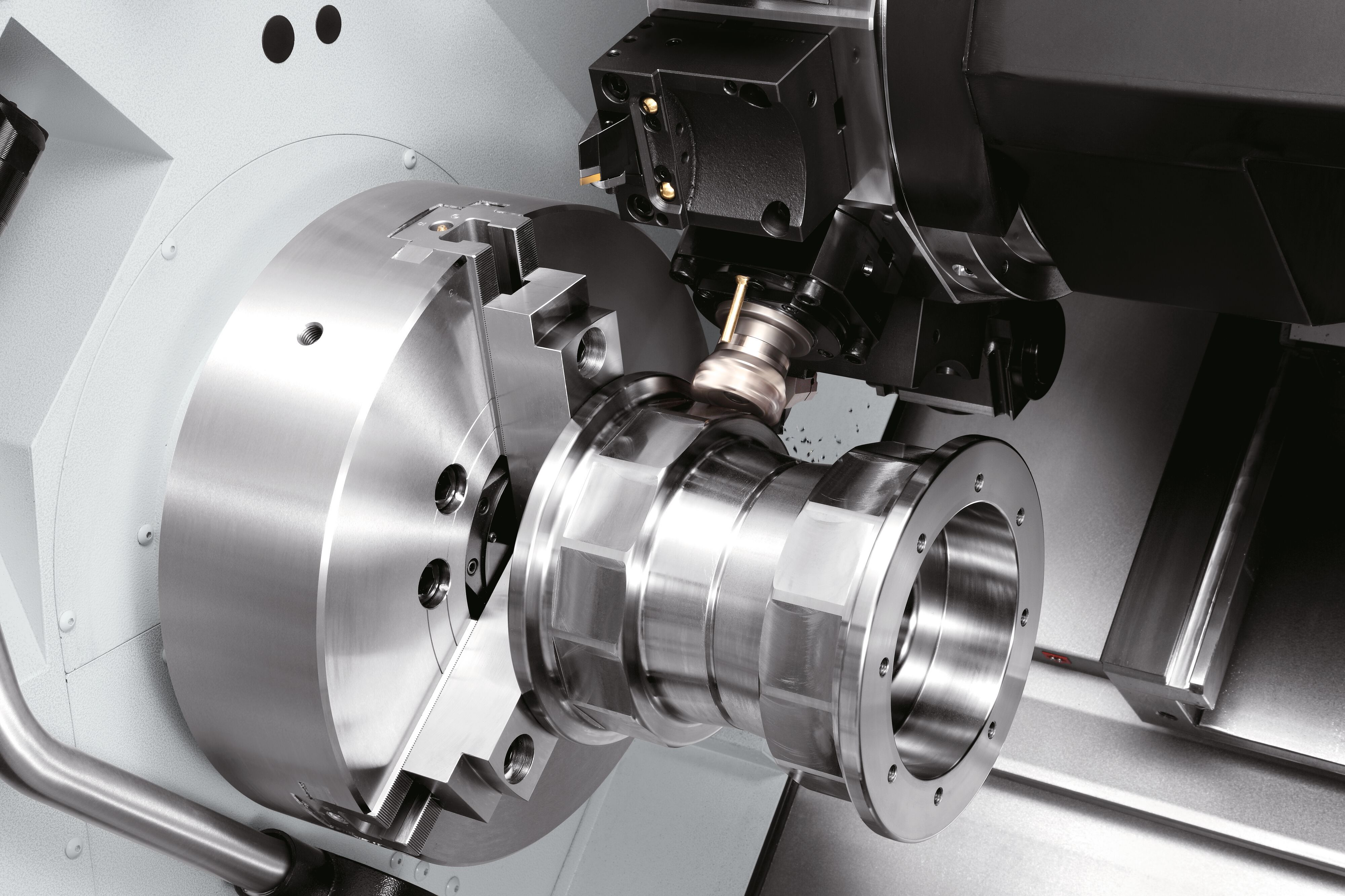

Enhanced and fine-tuned box guideways, stable roller guides with a width of 55 mm and double anchored ball screws ensure high rigidity in the machine’s guide and drive geometry. The sophisticated temperature stabilization and compensation minimizes thermal displacements coming from machine operation and environment. Among other measures, this is guaranteed by internally cooled ball screws, machine bed and spindle temperature control. In addition, direct measuring system smartSCALE provide longtime stability in production and prolonged drive accuracy. The turret is available as a BMT60, BMT40 or VDI40 with ten to 20 tool positions. The driven tools reach speeds of up to 12,000 rpm or torques up to 100 Nm depending on the machining needs. Designed for extreme heavy-duty machining, the left 10” turnMASTER spindle of the NLX 2500|700 2. Generation offers a torque of up to 828 Nm, optionally even up to 1273 Nm with the 12” version. The right spindle is available in 6”, 8” and 10” design with a torque of up to 577 Nm at the top end.
With a maximum turning diameter of ø 366 mm and a turning length of up to 705 mm, the NLX 2500|700 2. Generation offers capacity for a very wide range of workpieces. The maximum bar capacity for operation with bar feeders is increased to ø 105 mm on both spindles compared to ø 80 mm on the previous generation. The travel distances are 260 mm in the X-axis and 795 mm in the Z-axis. A travel of 120 mm (± 60 mm) in the Y-axis allows off-center milling, drilling and further operation with driven tools for more flexibility. Measurements can be carried out during machining at various positions, allowing users a high degree of process integration.
