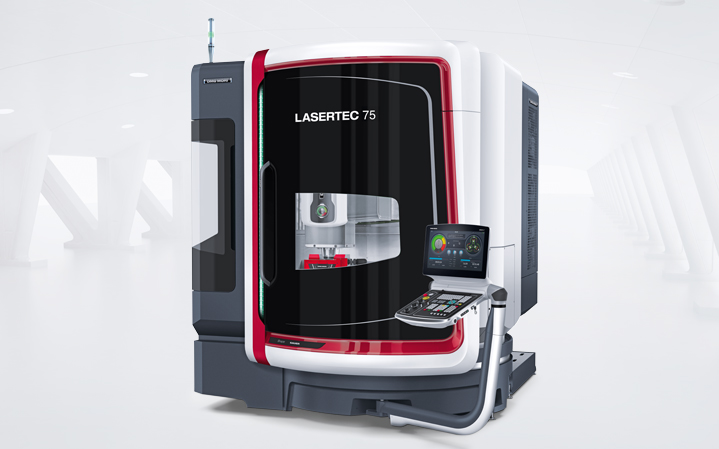

With a footprint of < 8 m², the LASERTEC 75 Shape is the ideal complement even in tightest production environments.

DMG MORI is prepared for this development and has only recently integrated the compact LASERTEC 75 Shape in its portfolio for laser texturing, which is already fully equipped for Industrie 4.0.  With a footprint of < 8 m², it is the ideal complement even in tightest production environments. Its ergonomic design with a door opening of 1,310 mm provides perfect access to the generously dimensioned work area. Workpieces weighing up to 600 kg (with the optional tandem drive up to 1,000 kg) with diameters of max. ø 840 mm and heights of 520 mm find sufficient space here. The traverse paths are 750 mm x 650 mm x 560 mm in the X, Y and Z axes.
The core elements of the LASERTEC 75 Shape are the powerfully pulsed 100 W fibre laser and the 3D processing optics. These are responsible for the material removal by 3D laser in layers and, in combination with the NC swivel rotary table, provide contour-parallel laser shaping. This enables fast and smooth laser texturing also for 3D free-forms.
When it comes to the control system, DMG MORI relies on a SIEMENS 840 D solutionline for the LASERTEC 75 Shape. Combined with CELOS, the machine can also be optimally integrated into the company organisation. User-friendly and application-related LASERSOFT software features ensure simple and productive operation of the LASERTEC 75 Shape.
