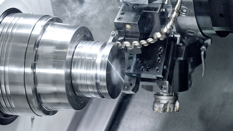

With its robust and rigid construction, the CTX 2500|700 offers the perfect basis for powerful heavy-duty machining combined with high surface qualities. The machine design was developed using FEM analysis. Robust guides in all axes ensure dynamic rigidity – the rapid traverses achieve up to 30 m/min – as well high vibration damping. Large-scale ball screw spindles as well 4-fold bearing of the spindle motors result in up to 50 percent higher overall rigidity compared with its predecessor.
Flat guides for maximum stability for example in grooving up to a 12-mm groove width in CK 45.
