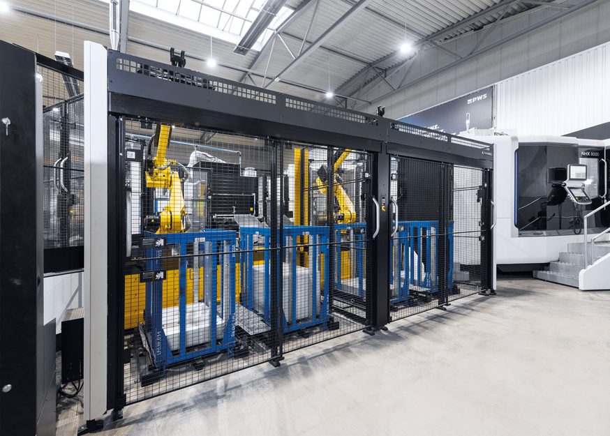

Each NHX 8000 has a pallet changer with one fixture per pallet, each of which is equipped with a panel at both sides. Two floor panels are manufactured in a single machining process.
One of the new machines has led to PWS expanding its technology portfolio to include innovative machining. “We produced a proto-type of a floor component for the battery for a large automobile manufacturer and ultimately received the order to manufacture the series,” remembers Steffen Metz, Head of Purchasing and Materials Management at PWS. “We were looking for a suitable manufacturing solution for this.” Our core business of punching did not technically meet the requirement and processing in a gantry machine was too inflexible for us. “In DMG MORI, we have found a partner who can reliably supply equipment to produce  the components to the required quality on standard machines, which has been verified by test machining in Wernau and now also in series production, of course.” The choice was quickly made to machine the part on an NHX 8000. Its work area provides sufficient room for the 652 × 980 mm components and, if necessary, the horizontal machining center will easily be able to be used for other jobs in the future.
The series production of the floor components involves up to 6,000 components per week. In order to be able to provide this capacity, PWS has purchased four NHX 8000 machines. Each has a pallet changer with one fixture per pallet, each of which is equipped with a floor component at both sides. Two floor components are manufactured in one machining process. The decisive reason for selecting DMG MORI as a partner in this project was the automation expertise of the machine tool manufacturer. Steffen Metz says: “It was clear from the start that we needed fully automated production in order to ensure process-reliable series production.” With the MATRIS system, DMG MORI designed an individual solution and also delivered the entire manufacturing process as a turnkey project, and all from a single source.
From the unmachined part to the ready-to-install floor component, including digital documentation
The NHX 8000 machines at PWS are equipped with #40 speedMASTER spindles as a special option.
PWS transfers the unmachined parts into the system using a special load carrier developed in-house with room for more than 100 panels. Two robots handle the workpieces at the center of the MATRIS system. The components are aligned and automatically clamped in the fixture at both sides. The two components that have already been machined are removed and transferred to the other stations. “The finished parts are cleaned using a blow-off device, a camera inspection system checks the holes and the parts are processed in a deburring machine. Each panel is then laser-marked with a QR code and scanned. “We use this to record all production data digitally in order to guarantee complete traceability,” says Steffen Metz. “The smooth process provides floor panels that are ready to install.” For further quality assurance, the MATRIS system was subsequently supplemented with a washing system and a flatness checker.
