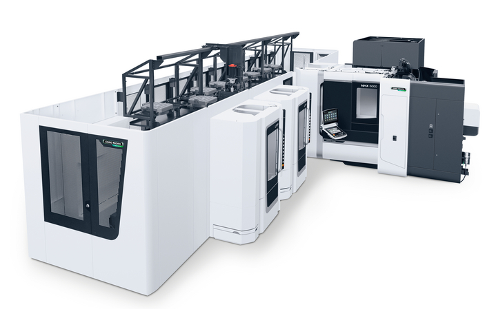

Four NHX 5000 machines are linked by a 78-station linear pallet pool.

Hamilton had already invested in recent years in machinery to expand its manufacturing capacity, including the five NHX 5000 machines from DMG MORI. In particular, this stand-alone machine with RPS 21 was soon running at full capacity due to the high production demand, explains Flavio Bass, Project Manager in the production department at Hamilton. The second automated production system with four NHX 5000 machines and a 78-pallet LPP was developed and installed by DMG MORI as a complex, digitized solution. The system has two setup stations and each machine is equipped with 360 workpiece stations. “Our goal is, of course, as much autonomous production as possible – even during unattended shifts at night and at the weekend,” says Flavio Bass. The large number of pallets provides ample scope for producing one-offs as well as small batches autonomously and to the required quality.

78 pallet spaces for multiple towers

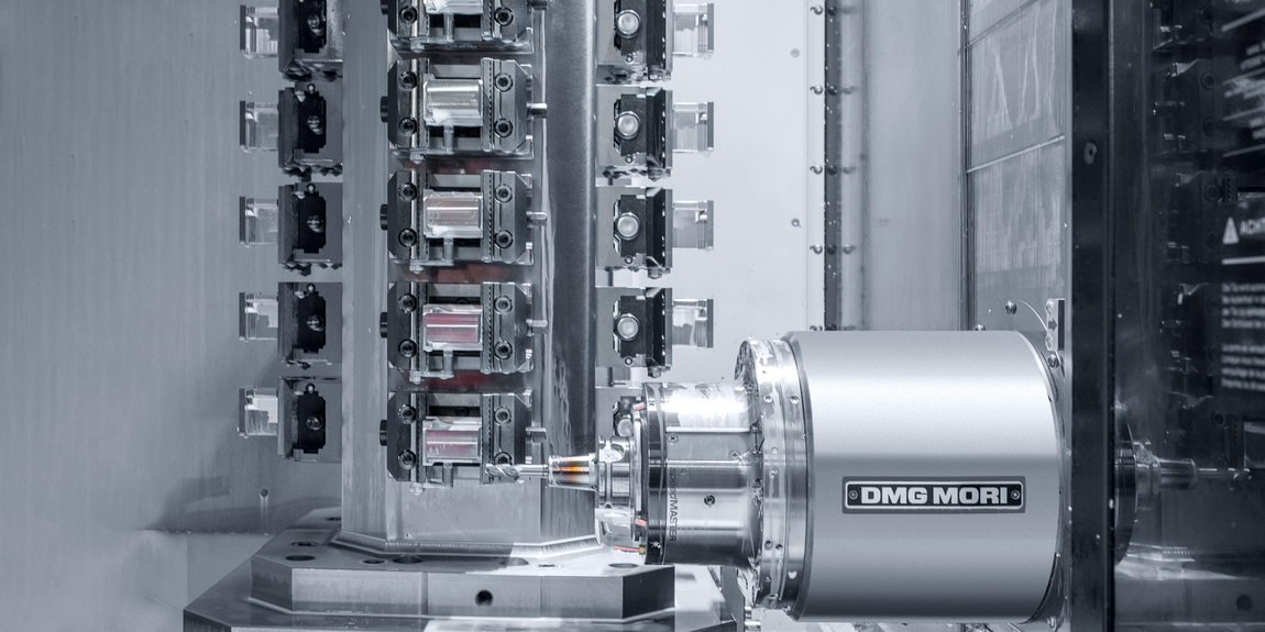

“Horizontal machining has the advantage that we can use four- or six-sided towers, which we can then load with several parts. As with the magazine for 360 tools, this reduces setup times”, Christoph Senti, Head of Mechanical Engineering at Hamilton goes on to explain. “Many components have relatively short running times so constant tool replenishment would be very uneconomical. As a rule, we load the towers so that half the workpieces require a first operation and the other half require a second.” Hamilton produces around 3,600 different components. Driven by innovations in production, their complexity and functionality are increasing. In addition, there are stringent demands on profile tolerances and surface quality.

Horizontal machining centers enable the use of four- or six-sided towers for workholding. This allows Hamilton to reduce setup times significantly.

In order to further optimize the production process, half the towers are loaded with parts for front face machining and the other half with parts for rear face machining.
