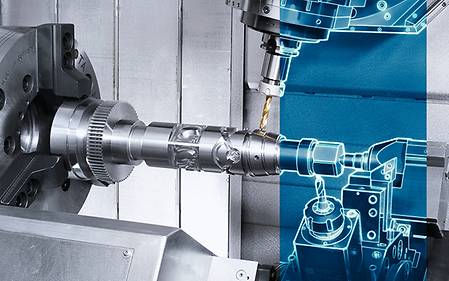

  • Center point mounted on the turret
  • Center point data is saved directly in the tool memory
  • For fixed and spring-loaded center points
Customer Benefits
  • Easy operation for positioning the center point
  • Position-locking the of the turret leads to increased process safety
  • Pressing force of the center point is variable, programmable and monitorable
Tailstock for turret
Start position and support position in X and Z-axis can be programmed via the operator screen. Monitoring of support position in a predetermined window.
