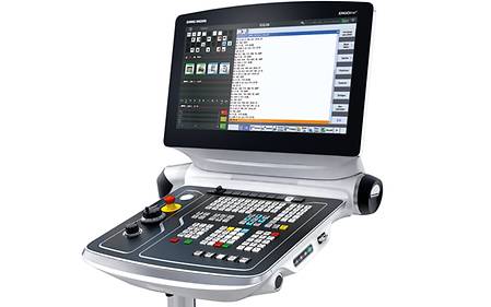

User interface Presentation of the program condition with additional markers (EPS) for the sub-program. Input of remarks by the operator, or automatic by the GILDEMEISTER programing.
  • In combination with the Gildemeister structure programming, a safe and fast reboot of the machining program after an interruption
  • Easy program operation, especially with multiple spindles or tool magazine
  • Displays the process status of the workpiece
