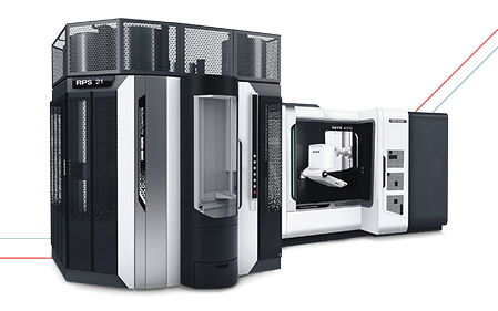

RPP (21 stations) with NHX 4000 2. Gen.
  • Space-saving automation solution for single machining center with 400 or 500 square pallets
  • Prepared for unmanned operation including various options like auto coupler I/F
  • 5 pallet system with random operation, 1 setup station and pallets on 1 level (14 pallets in 2 layers and 21 pallets in 3 layers available)
  • Easy operation using machine controller of HMC with self-explaining pallet manager software
Technical data
Maximum workpiece weight (lbs.)
Maximum pallet/workpiece size (5/14) / (21) pallets (in.)
Capacity
NHX 4000 2nd
881.8
Ø24.8x
H1,984.2 / 27.6
5/14/21
NHX 5000 2nd
1,102.3 lbs. option: 1,543.2 lbs.
Ø31.5x
H39.4 / 27.6
5/14/21
NHX 5500
1,543.2
Ø31.5x
H43.3 / 27.6
5/14/21
