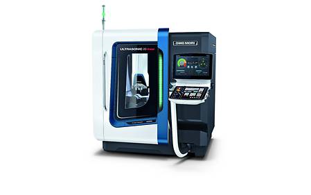

With a new look and improved performance across the board the new 2nd generation ULTRASONIC 20 linear impresses in demanding ultrasonic machining.
The decisive technological innovations of the ULTRASONIC 20 linear 2nd generation include a new, completely digitally controlled ultrasonic generator plus ULTRASONIC actuators with enhanced performance.

The smartSONIC is used in the 2nd generation ULTRASONIC 20 linear as a new ULTRASONIC generator. This automatically recognizes the ULTRASONIC frequency that is best suited for actuator and tool. As another world first it also tracks the frequency and amplitude power during the machining process. To achieve this the smartSONIC automatically tracks the frequency response and compensates all external impacts, such as damping of the ULTRASONIC vibrations caused by the prevailing process forces. This results in consistent control of the set amplitude or that defined in the NC-program. So the user can maximize his process to the utmost and thus increase tool utilization, minimize cycle times and most especially achieve even more filigree, accurate and high-quality manufacturing results thanks to the reduction of process forces.
DMG MORI relies on the long-term stable gantry design for the 2nd generation ULTRASONIC 20 linear in order to meet the demands on precision for ultrasonic machining. Whereby the machine tool manufacturer was able to reduce the footprint to a compact 37.7 ft². A duel drive in the Y-axis and the integral cooling concept that includes temperature monitoring of drives and spindles as well as the control cabinet and all media guarantee top precision and component accuracy. The linear scales from Magnescale are another example of the high-tech components used by DMG MORI here.
