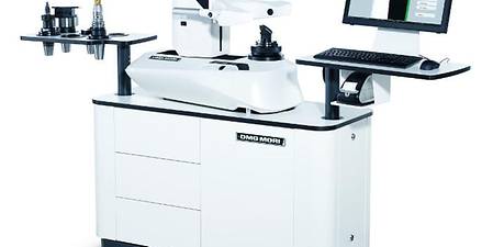

Fully equipped UNO 20|40 in the “automatic drive” version
The models of the UNO series are available in two sizes. The UNO 20|40 kicks off with a 400-mm traverse path in the Z-axis while the UNO 20|70 has a travel of 700 mm. Both versions are available as tabletop devices with a 19” screen. There is a 22” or 23” touch display available as an option as well as the comfort system cabinet. Unique here is the possibility of measuring tools with diameters up to 100 mm with the snap gauge principle even with the standard version thanks to a traverse path of +200 mm to -50 mm in the X-axis. And of course all conventional tool interfaces such as HSK, Capto, VDI, KM or BMT can be realised by adapting the spindle in addition to the SK 50 that comes with the standard version.
Lothar Sommer goes on to explain the solid basis of the UNO tool presetting devices: “You can only get this class of FEM-optimised and thermally stable grey cast iron construction from DMG MORI.” The inherently rigid bed with 3-point support not only ensures safe footing but highest flexibility in the workshop as well thanks to simple setup. The integrated infinite fine adjustment in both axes and the segment incident light for visual control of the cutting edge are also outstanding features included in the standard version. The UNO “sets new standards in the entry class of tool presetting”, claims Lothar Sommer. “The release-by-touch operation in particular and the large touch display for even better handling of the MICROVISION software make work so much easier.” The high-performance software enables simple and operator-independent measuring in all equipment configurations.
Lothar Sommer highlights the benefits of the latest generation of this software: “MICROVISION offers intuitive operation for the user and with its helpful functions quickly achieves highly accurate measuring results. Accuracy is aided by a focusing window, which enables exact positioning even for highly complex tools.
A thermal label printer, vacuum clamping, a second camera for setting the centre of rotation and a multitude of other options round off the latest UNO series.
