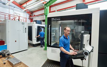

Installation of the first machine for high-speed machining at Werkzeugbau Erz in 2012 – the HSC 105 linear – was followed in 2014 by the HSC 70 linear, the second HSC model from DMG MORI.
The origins of Werkzeugbau Erz date back to a service provider specialised in milling technology that was founded in 1989. The company has grown since then to become an integral supplier in the field of tool and mould making as well as injection mould technology. 15 competent employees ensure maximum quality and precision in production. An extensive machine park from DMG MORI, which includes two machining centres from the highly dynamic and extremely precise HSC series, comprises the technological basis here. The latest acquisition is an HSC 70 linear with Erowa automation.
