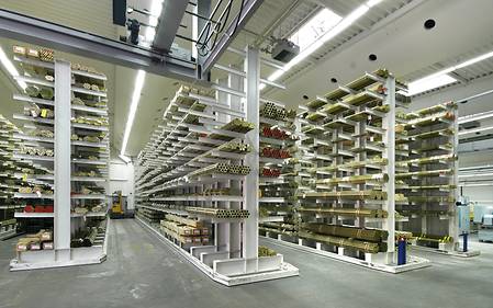

An extensive high-bay warehouse with 1,400 tons of brass raw material ensures both a high degree of availability and flexibility. Flühs processes 75 tons of the metal a day.
