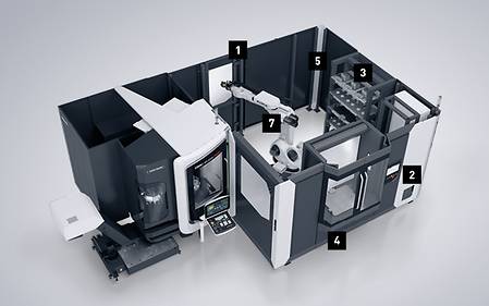

WH FLEX BASIC CONFIGURATION
EQUIPMENT
1. Protective guard with access door
2. Basic cell control with HMI touch panel
3. Basic rack
4. Basic setup station
5. Single gripper module
6. Control cabinet with control system and basic sensor system as well as basic pneumatics
7. KUKA robot KR60
8. Storage for pallets
TECHNICAL DATA
Footprint: 177.95 × 162.01 in (without machines)
Transfer weight: 132.3 lbs
Robot radius of action: 95.63 in
Basic rack with five shelves
Basic setup station designed for max. pallet size of 31.50 × 23.62 in

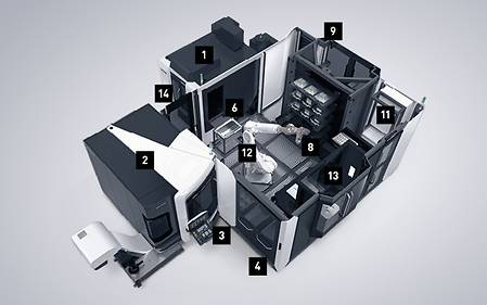

WH FLEX EMO SHOWCASE
CONFIGURATION EXAMPLE
1. DMP 70
2. DMU 40 eVo
3. NOK drawer
4. SPC drawer
5. Passive checking station
6. Cleaning station
7. Active gripping / turn-over station
8. Double gripper
9. Rotary rack
10. Paternoster
11. Control cabinet with control system and basic sensor system as well as basic pneumatics
12. KUKA robot KR 150
13. Rotary setup station
14. Protective guard with access door
+ Basic cell software
+ Grid programming
TECHNICAL DATA
Footprint: 208.19 × 179.60 in (without machines)
Transfer weight: 330.8 lbs
Rotary rack with five shelves
Rotary setup station with two pallet locations
Paternoster with 24 trays
(effective revolving use)

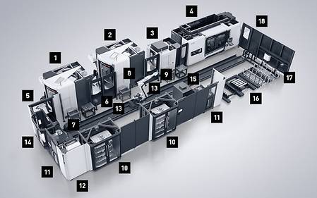

WH FLEX LINE
WH FLEX LINE
1. DMU 60 eVo
2. DMU 80 eVo
3. CMX 800 V
4. CTX beta 2000
5. NiO / SPC drawer
6. Passive checking station (3×)
7. Cleaning station (3×)
8. Active gripping / turn-over station
9. Double gripper
10. Rotary rack (2×)
11. Paternoster (2×)
12. Control cabinet with control system and basic sensor system as well as basic pneumatics
13. KUKA robot KR 300 on linear seventh axis
14. Rotary setup station
15. Laser marking unit
16. Pallet magazine
17. Scanner
18. Protective guard with access door
+ Grid programming
TECHNICAL DATA
Footprint 787.40 × 236.22 in (without machines)
Transfer weight 330.8 lbs
